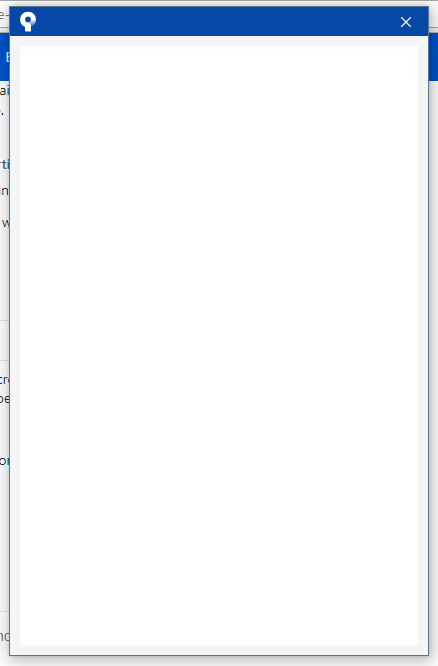

Not able to sign in to sourcetree. It shows some kind of white screen when I try to login.

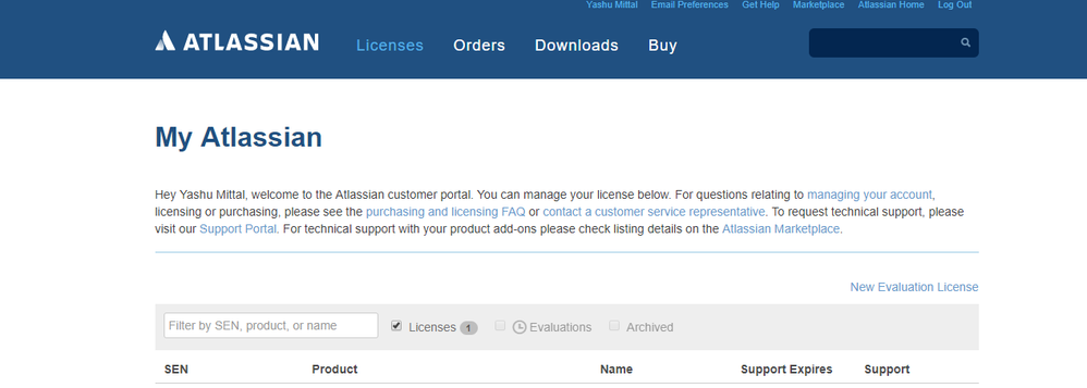

I have done creating two files accounts.json and passwd, but nothing happening.
When I click on "Use an Existing Account"
and when I click on "Go to my Atlassian". It opens up this page

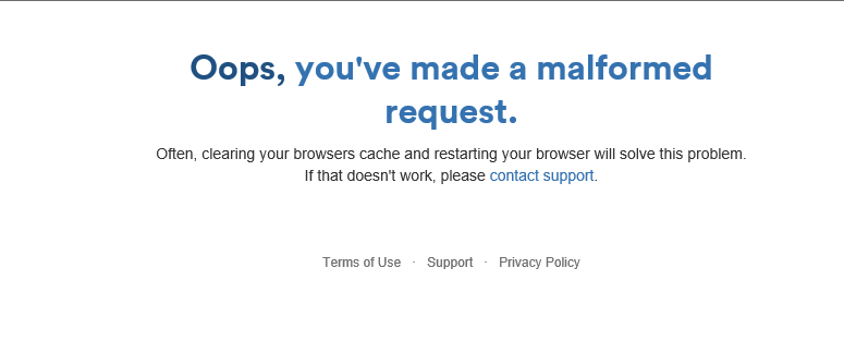

When tried running in internet explorer.
