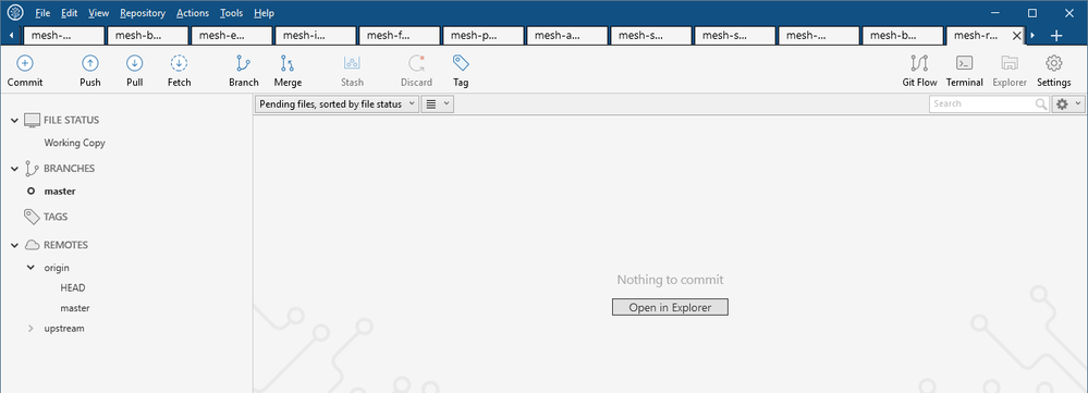

When the name of a project is a little longer than one word, the tabs are no longer distinguishable anymore, they only show the beginning of the project name. On my screen in SourceTree all tabs have the same caption for that reason. It is really hard to work like this.

We upgraded a few weeks ago, tried living without the sidebar but finding it a big step backwards in productivity. Particularly as our 100+ repos all share a common prefix...
Please consider bringing back the sidebar or consider alternatives for working with large, organized sets of repositories.
At the moment I can fit up to 10 repositories tops in the new tabbed UI in 2.0.20.1. Like so many others before it is hard to see which tab you are actually on. (waiting to see the improvements in v2.1)
Just wanted to add a screenshot of what people are talking about when they say all projects beginning with the same prefix look identical :-D
