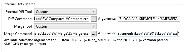

I am having issues with setting up labview merge and compare tools as external tools in sourcetree 3.0. The documentation I found was for pre 3.0 versions. It should be possible to set up an externel merge tool by clicking tools > options > diff ? I can then set the path to the relevant VI's, but I am not sure this is the right approach? At least it does not seem to work.

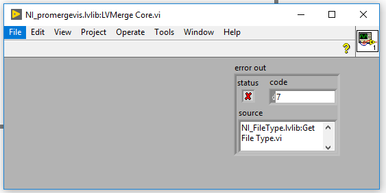

Thanks for your reply! It seems to be more right now. However, it is not quite working yet. I have made a change to a file called "xxx.vi". In the "file status" tab I hightlight the file at hit ctrl+d to launch the external diff tool. Labview compare then launches with the error message seen below. Is there somewhere in sourcetree I can set the exact command that is executed, or how can I fix this problem?
When I try to resolve a merge conflict using the external merge tool, labview opens with the error seen in the attahced picture. Perhaps incorrect parameters are causing this problem as well.
LVCompare was called with incorrect parameters.
How to call LVCompare:
LVCompare <absolute path to vi1> <absolute path to vi2> [-lvpath <absolute path to LabVIEW>] [-noattr] [-nofp] [-nofppos] [-nobd] [-nobdcosm] [-nobdpos]

Thanks for your reply! Something seems to work better now. However, it does not quite work yet. I tried to make a change to the file "xxx.vi". In the tab "file status" I highlighted the file and pressed ctrl+d to launch the external diff tool. Labview compare then opens and gives the error message seen below. Is there somewhere I can set the exact command executed by sourcetree, or how can I fix this problem?
When I try to resolve conflicts in a merge with the external merge tool, labview open and gives the error message seen in the attached picture. Perhaps It is due to incorrect parameters as well.

I get the same error message, when I try to run the external diff tool. You can see my inputs to the diff options below:Capture.PNG
Diff command:
C:\Program Files (x86)\National Instruments\Shared\LabVIEW Compare\LVCompare.exe
Arguments:
\"C:\Program Files (x86)\National Instruments\LabVIEW 2018\LabVIEW.exe" \"$BASE\" \"$LOCAL\" \"$REMOTE\" \"$MERGED\"
Merge command:
C:\Program Files (x86)\National Instruments\Shared\LabVIEW Merge\LVMerge.exe
Arguments:
