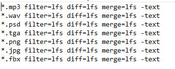

The problem is that eaven though we have a file that has the LFS rules set up, my computers version of Sourcetree does not read that file at all. If I try to commit an mp3 file to the repository it prompts me that the file should be tracked with lfs. On my friends machine that I setup at the same time everything works as it should.
This is what the .gitatributes file has inside of it.

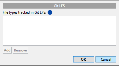

This is what the Sourcetree LFS tracking window shows. It is empty, on the other machine I setup it shows the rules and everything works.

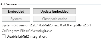

I have tried from Options -> Git > Embedded and System, neither does nothing.
I also tried to make a competely new Repository, initialised LFS, added rules and everything works like it should. Then I can see the LFS file types tracked in the window. As soon as I cloned the existing Repository from the GitLab it again lost the connection to the .gitatributes file and the LFS stopped working.
