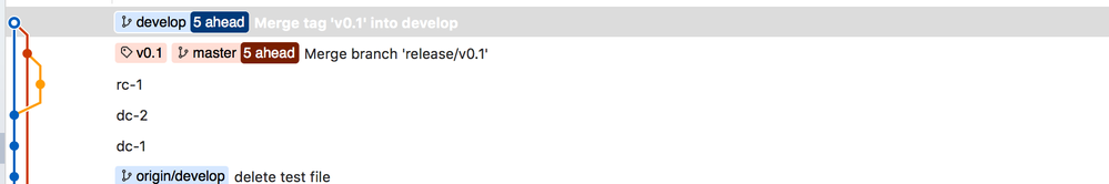

February 15, 2018
Hi @Richard Senior
I'm on the latest version of Sourcetree v2.7.1(157) and I don't see this issue. My release branch was merged both to master and develop and deleted after that. I've attached below screenshot that just shows the same. gitflow_demo.png
