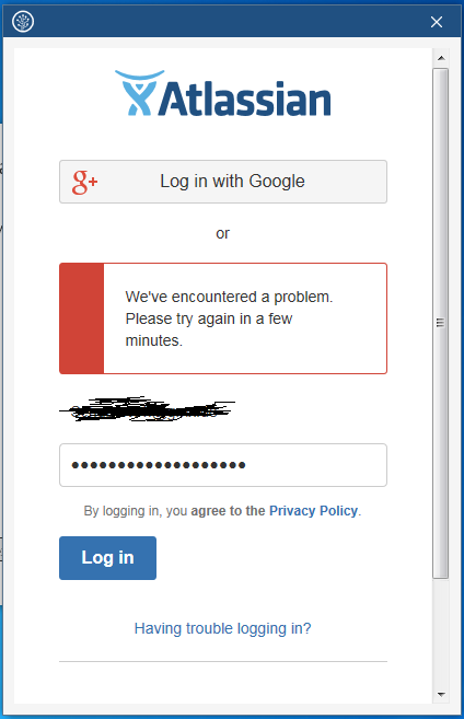

I've tried to install SourceTree (2.1.2.5) on Windows 7 several times over the last two days. It always gives the message "We've encountered a problem. Please try again in a few minutes." in step "Atlassian account" (see attached screenshot). I try to login with my Atlassian Id. Id and password are correct (I've used the same to login to ask this question).
What is the problem that has been encountered? When will this problem be fixed?

To every one, try "Reset your Internet Explorer Settings" in IE internet option advanced tab, also check "Delete personal settings"

Hello everyone, could you try the following workaround:
  1. Open IE, click on the gear
  2. Select "Internet Options"
  3. Select the "Security" tab
  4. Select "Custom Level" for Internet
  5. Find "Access data sources across domains" and select "Enable" (make note of what the setting currently is)
  6. Try logging into Sourcetree again
  7. After loggin in, follow steps 1-5, but reset the setting back to the previous option.

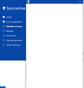

I have a related problem, with the latest 2.3.1 release.
I just get a white page where the login page is to be shown in the installer.
Fiddler reports that several web requests have succeeded, among them some js/css files.
Right-clicking the window, I can view the source. If I save that source to a physical ".html" file and run that, I can see the login screen, but it doesn't work (obviously).
For what it's worth, I can log in to the web just fine, using IE11 with the same URL that I get from the properties of the blank login page.
I'm under an enterprise regime, and can't change any IE settings. Have tried deleting temp files etc., but no luck.
