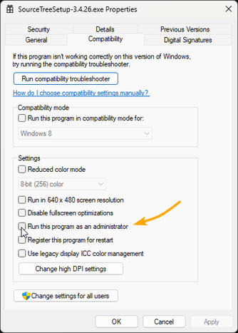

3️⃣ On Windows, when you navigate to Properties (installation file) > Compatibility, there is an option "Run this program as an administrator." Make sure this is unchecked.
