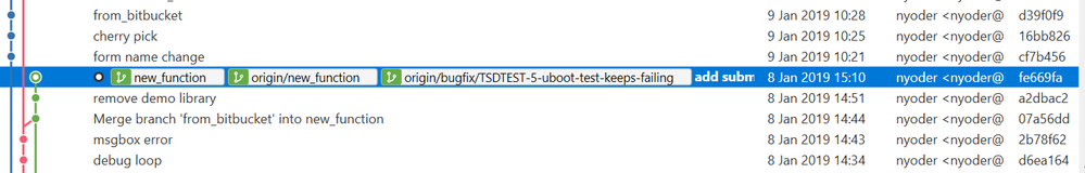

If am having a major problem checking out branches. If several remote branches are all at the same commit as each other (for example, if I have just created a new branch), they all appear on the same line of the history. How the heck do you choose which one you want to check out?
Double clicking or right clicking "checkout" seems to check out one of the branches at random -- I think it must be whichever one already has a local branch created for it. Sourcetree does not prompt me to select which remote branch I actually want to check out locally.
Also, if I already have the master checked out, and I want to check out a branch that has just been branched off the master, the "checkout..." option is greyed out entirely. So, how do I switch between branches that are on the same line of the history???

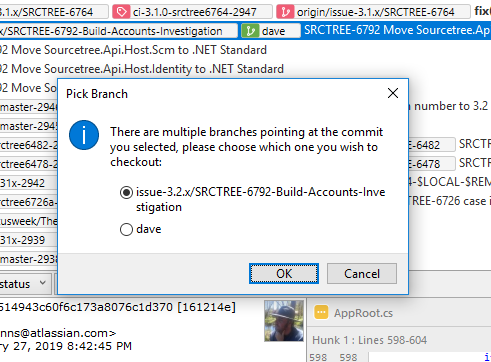

Sorry I re-read your question.
If you right click on the row in the Log View and choose Checkout... you will be presented with a dialog giving you the ability to choose the branch.
Thank you for understanding my problem.

I tried your suggestion (though I have done it many times in the past with no luck) and I was surprised that I did get the dialog you showed me. HOWEVER I only get this dialog about 25% of the time when clicking a commit with multiple branches.
Another 25% of the time I instead get a dialog that lets me select between every single branch in the repository -- again useless.
The other 50% of the time Sourcetree randomly selects a branch for me and checks it out.
