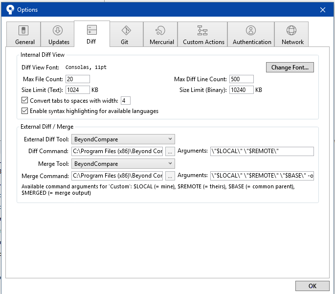

Based on my current setup, all I can suggest is to upgrade to BC4 Pro.  BC 4.2.8 works fine with Sourcetree.  I've attached a screenshot of my diff settings page in Sourcetree.  Note the arguments to BC, which I think were inserted automatically by Sourcetree.

Thanks Patrick, I have exactly your same settings on the Diff dialogue, the only difference is that BC version is the 3.x.x (but sourcetree correctly detected it and automatically found its path, I didn't have to change it).
