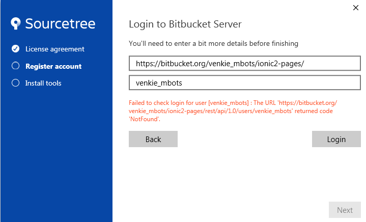

How can i setup SourceTree if it showing error like this ?
Venkie
May 24, 2018
I've given my root URL and User Name correctly (I assume). After that prompted for pass word, entered. Even then can't get into Source tree, I tried with Atlassian account too. But no positive result . Please help me.

Hi Venkie! Looks like you're trying to register Sourcetree using the Bitbucket Server option, but you're offering your Bitbucket Cloud URL instead. If you don't have Bitbucket Server, you'll need to register using the other option (Atlassian account) and once the installation is completed, you can connect your Bitbucket account as explained at Connect your Bitbucket account.
Also, if you're using Windows, make sure Internet Explorer is updated to the latest version as Sourcetree relies on it for authentication.
Let us know if you have any questions!
