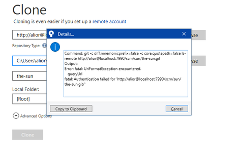

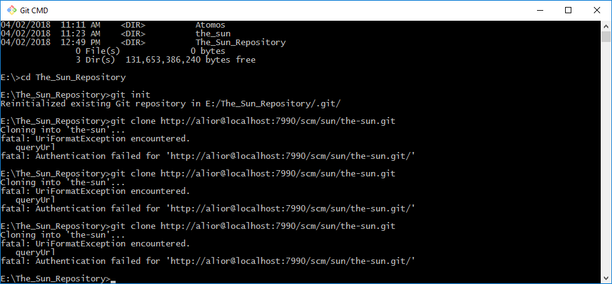

Hi! I have an issue with checking out from server on my PC using Git and/or sourcetree.
I am getting an exception when trying to use git cmd:GIt cmd.png

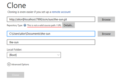

Also there is and issue with trying to check out using atlassian (both, embeded and system git)

Hello! I suspect this is an issue with the Git Credential Manager for Windows due to the fact that cloning from the command-line isn't working. Can you make sure you have the latest version of Git installed?
If it doesn't work after updating, please refer to the project on GitHub for help. Thanks!
Ruslan Kudriachenko
April 4, 2018
Hi! First of all, thanks you for your help. There was installed the last version of Git. Your idea about Git Credential Manager was helpful as after uninstallation of the manager I was able to use server properly. Thanks for attention.
Uninstallation of git credential manager for windows:
 was able to uninstall the Git Credential Manager for Windows using the uninstall option:
git-credential-manager.exe uninstall
Run this command in C:\Program Files\Git\mingw64\libexec\git-core (or location you installed your git)
