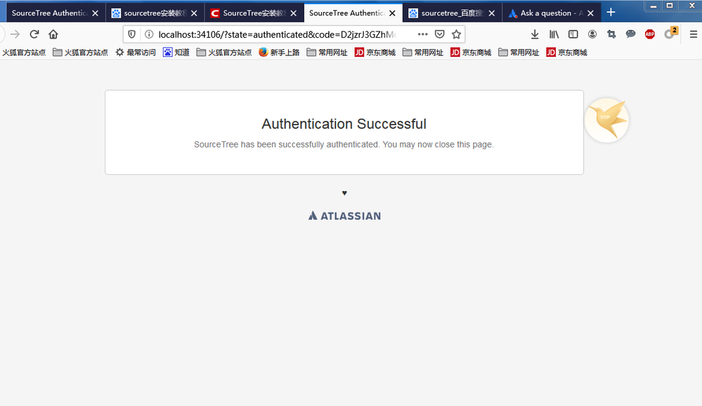

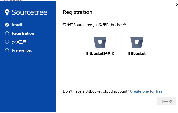

HELP !the aucentication is sufccessfull ,but it can not skip the registration step!

I got the same problem trying to install version 3.3.6.
When prompted to I logged into my account but the installer just sits there "Waiting for login to finish" forever.
When I exited the installer and tried again I get the same Authentication Successful page and the installer stuck.
I've cleared the browser cache and now I'm back to the Waiting for login again.

I got  a way to solve it.
1 step : unstall and clear all the info including the associated of souretree.
2 step: copy the folder of souretree which has been installed and running successfully  to your current computer where you want to use sourcetree  at ;
3) click the souretree.exe which locate in the folder.
4) now ,you will see the resgister pomt.do not close it. and go to "%LocalAppData%\Atlassian\sourcetree". create a "accounts.json" file, then  copy the content below into it and save it   :

4) re-open the sourcetree.exe. you can find the register promt has dispeared. and now you can go on next step.

Clear your browser cache and try again or try using a different browser and check if that works.

I have tried lots of times.  the problem can not be solved still.Someone give me a tip ? my grat!
