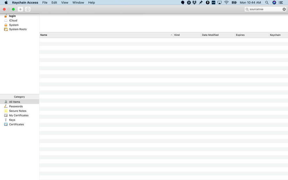

What can I do to fix this? I've already lost all my settings (by deleting the directory). I don't see SourceTree items in KeyChain.

I also tried all of the above but still getting same error.
Tried re adding the account
Tried re installing the app
But still not working
there are no key chains.

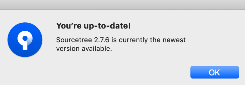

Please update the app to 2.7.4(175) for security updates with the new version of git. Should you see the same errors, please add screenshots of the account configuration errors and logs from ~/Library/Logs/Sourcetree/
You can quickly access the logs and set log level by enabling Debug menu in Sourcetree. You can navigate to Advanced tab in Preferences window and enable the debug menu check box. With that, you will see a new Main Menu Item next to Help and this has all the necessary options for logging. Please enable Authentication Logging and Set Log Level to Verbose.
Hi Sorry for the late reply. Updating the app has solved my issue now.
