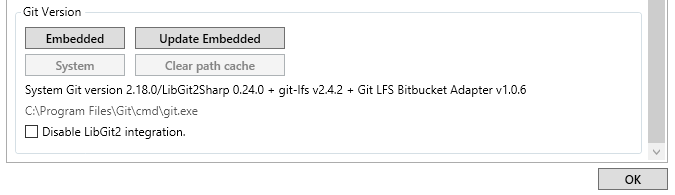

Adding this from the Git options tab in case it's helpful:
