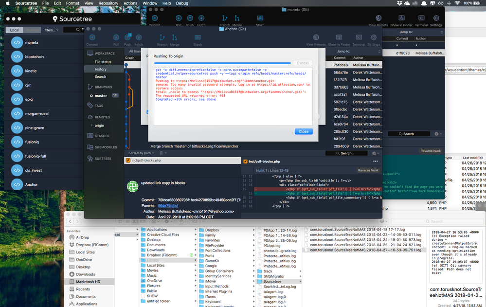

MelissaB1517
April 30, 2018
Screen Shot 2018-04-30 at 1.38.57 PM.pngI've tried to push twice and am still getting the same error, I don't see a recent error log from today though

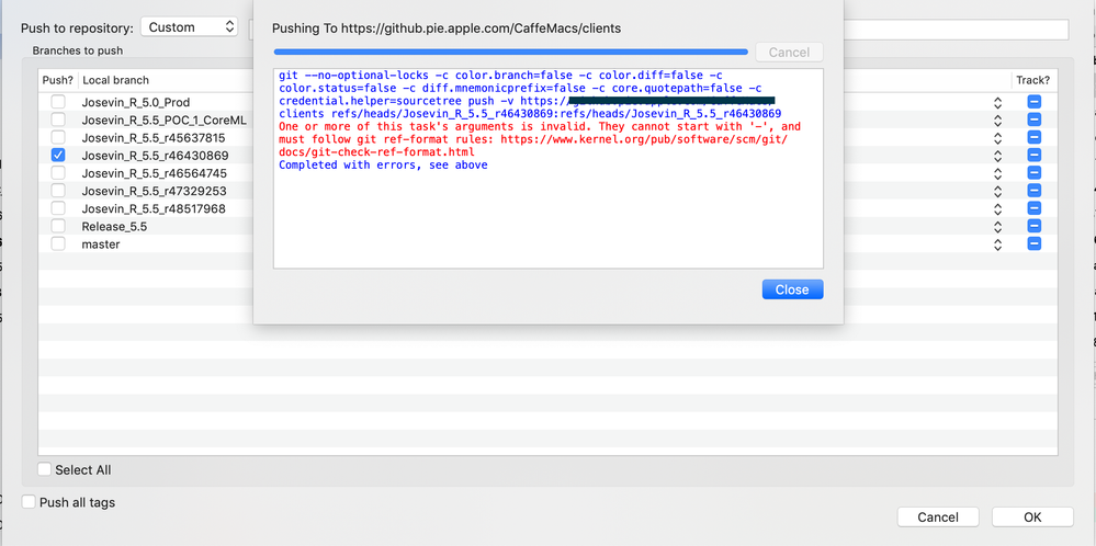

Josevin
March 21, 2019
Hello,
I am also facing the same issues and tried custom but no luck, getting below error. please help
