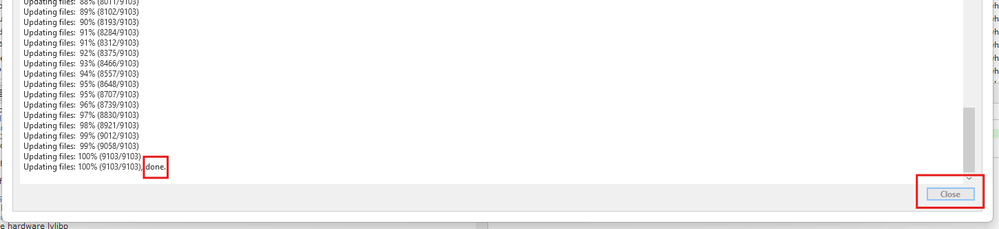

Hi,
I have a large repo (5.8GB) that I am trying to clone. I am checking out a fresh copy of develop branch.
So the Updating Files says its "done" but the [Close] window is not enabled.
Its almost as if sourcetree is validating its check out.
Can anyone help me understand this behaviour?

Hi @deejaycrawford ,
Apparently, this is a known issue. Here's one bug report related to Bitbucket but from what I've managed to dig out, a similar thing happens in Sourcetree (as you described): BCLOUD-23786: Unresponsive "Close" button in commit file view
You can try checking open bugs/suggestions on Sourcetree, but I haven't managed to find this specific issue.
Seems like this is not related to the size of your repo, and the clone operation itself is likely completed if "Updating files" status says "done". You should be able to close the window using standard window controls if the button remains disabled. 👀

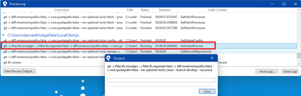

There is a long running process seen in the process log viewer
No, my local copy is a mess. I have to delete and start again.
Everything was fine with the previous versions of
Sourcetree
git
git-lfs
Our source code is binary format so we are potential "abusing" the GIT LFS system
