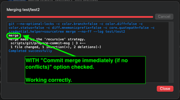

The "prepare-commit-msg" script should output the second parameter as: "merge".
This can be verified by performing a merge WITH the "Commit merge immediately (if no conflicts)" option checked (which will result in the correct value of "merge" being printed).
See attached screenshot "with_option_checked-CORRECT.png"

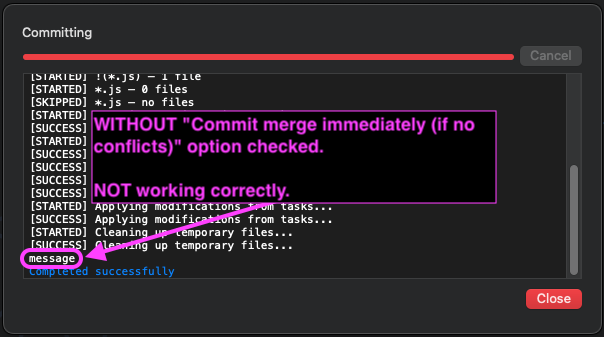

Actual Result
The "prepare-commit-msg" script outputs the second parameter as "message" (which is incorrect; it should be "merge").
See attached screenshot "without_option_checked-WRONG.png"
