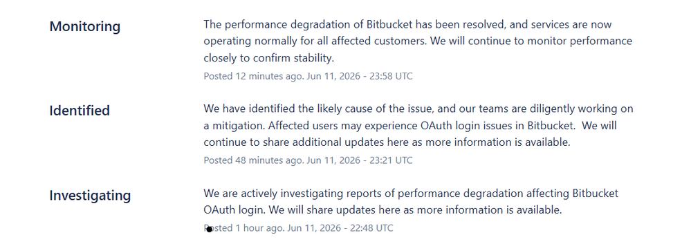

Identified We have identified the likely cause of the issue, and our teams are diligently working on a mitigation. Affected users may experience OAuth login issues in Bitbucket. We will continue to share additional updates here as more information is available. Posted 12 minutes ago. Jun 11, 2026 - 23:21 UTC Investigating

was about to log a ticket and saw this:
https://bitbucket.status.atlassian.com/incidents/h51sr145gsmx
Identified We have identified the likely cause of the issue, and our teams are diligently working on a mitigation. Affected users may experience OAuth login issues in Bitbucket. We will continue to share additional updates here as more information is available. Posted 12 minutes ago. Jun 11, 2026 - 23:21 UTC Investigating We are actively investigating reports of performance degradation affecting Bitbucket OAuth login. We will share updates here as more information is available. Posted 45 minutes ago. Jun 11, 2026 - 22:48 UTC
