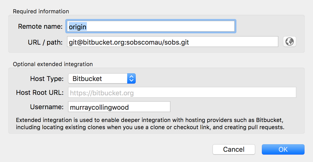

We found the problem.  After migrating to the new MBP somehow the install settings for Bitbucket had been changed.  The correct settings (as now configured):
Before we corrected this the Host Root URL had a value of https://www.bitbucket.org
I hadn't added that value.  My process was (afaicr):
a) Install the latest Sourcetree
b) Login into my Bitbucket account
c) Open the local repository
Not sure if that helps you in applying a fix to Sourcetree, but perhaps somewhere in the setup code there is a default 'www' that shouldn't be there?
