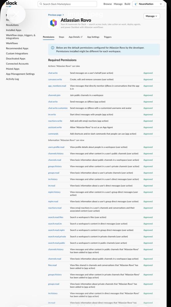

However, look at the permissions actually officially listed below. This indicates to me that there is a bug as it’s requesting a permission it did not officially declare for the app:
And I don’t see anything relevant to set in settings. I would approve it anyway, but even when disabling app approval the error would stay.

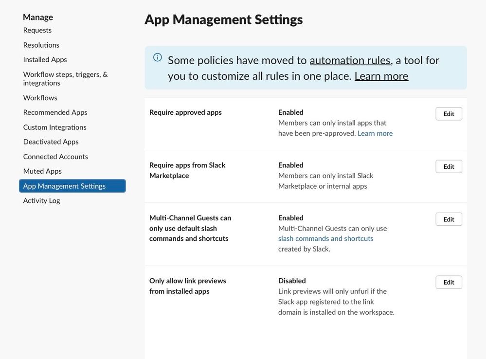

Is app aproval enabled in your Workspace ?
You can check it here: Slack Admin → Apps and workflows → App requests / Approved apps

If you mean the setting "Require approved apps": Yes, it is enabled to require admin approval. I'm one of the admins and would have permission to approve. However, even if I disable that setting temporarily, the error stays.
