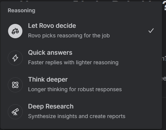

Rovo Chat uses different LLMs than Rovo Agents. Also, the default behaviour for Chat is now that Rovo chooses its own way of "reasoning". There are three modes
Compare Rovo Chat reasoning modes | Rovo | Atlassian Support
Depending on the question, Rovo Chat will run in either of these modes. Rovo Agents can now do Deep Research as well, but that feature may not be rolled out to your site (see Deep Research in Rovo Agents: Custom, Trusted and Tailored AI Insights for reference).
Another difference might be the used skills. Rovo Chat can access all skills (fka Actions) but only uses a few. An Agent only has access to whatever you gave it access to.
Without having analyzed your Agent Prompt, I'd suggest you check the Rovo Chat interaction in detail. Maybe screen record while Rovo is working - it will give you information on whatever it's doing at the moment (searching, creating etc.) so you get insights into used skills etc. The logs may be helpful as well. If the reasoning level doesn't show up automatically, just run the same prompt in the different modes to compare. Once you know what Chat is doing, you can compare to whatever the Agent is doing.
