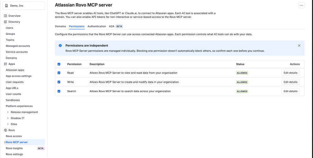

Jerome Grunnagle _Trey_
April 22, 2026
There are no events in the org's audit logs. I've enabled these permissions in the admin panel:
