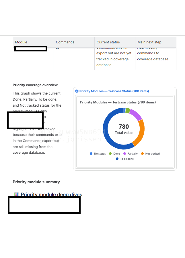

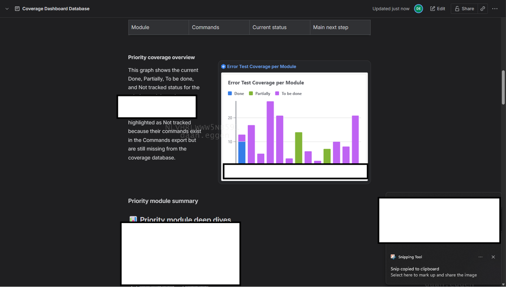

We have created a Confluence dashboard containing 12 Rovo Charts that visualize data from our testing coverage database.
The chart configuration itself is correct. However, the embedded chart previews on the published Confluence page frequently display the wrong chart.
For example, a location configured to display a donut chart ("Priority Modules — Testcase Status") instead displays a completely different bar chart ("Error Test Coverage per Module").
Clicking the embedded chart always opens the correct chart configuration, indicating that only the embedded preview is incorrect.
Different users may also see different charts on the same page.

  • Screenshot from User A (correct chart displayed)
  • Screenshot from User B (different chart displayed in the same locationown frame.pngFrame colleague.png

@Jordy Jorissen based on your testing, I agree this is worth treating as a defect rather than continuing to troubleshoot individual chart configurations.
The detail that stands out is that the preview is wrong, but selecting it opens the correct chart. Combined with different users seeing different incorrect previews and the problem becoming reproducible with a larger number of charts, that suggests the embedded chart rendering/state is getting mismatched rather than the underlying Rovo Chart being configured incorrectly.
I also wouldn’t spend your time determining whether the threshold is 8, 10, 12, etc. You already have a useful reproduction case: approximately 12 charts reproduces it while a page with 3 does not.
