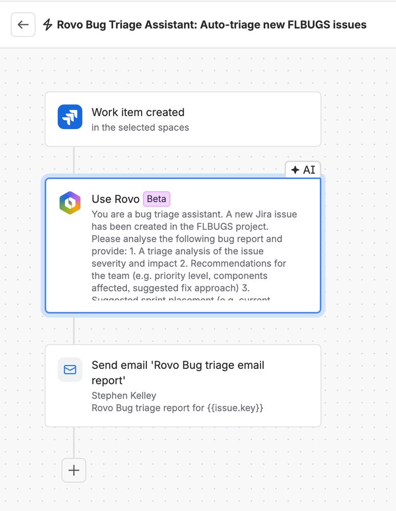

Having similar issue. Trigger on new ticket in Jira project -> Use Rovo -> send email. Use Rovo prompt:
You are a bug triage assistant. A new Jira issue has been created in the FLBUGS project. Please analyse the following bug report and provide:
1. A triage analysis of the issue severity and impact
2. Recommendations for the team (e.g. priority level, components affected, suggested fix approach)
3. Suggested sprint placement (e.g. current sprint, next sprint, or backlog)
Use Rovo and Teamwork graph search across all available source, especially Jira, Confluence, Github. Include relevant links in report.
Issue Key: {{issue.key}}
Summary: {{issue.summary}}
Description: {{issue.description}}
