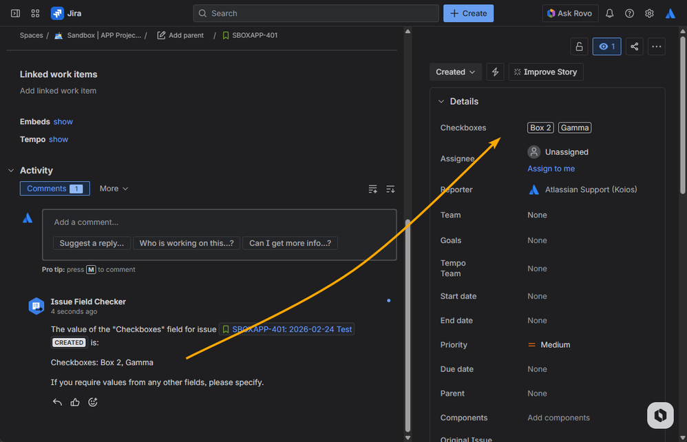

So I did a couple of quick tests and I've managed to get my Rovo agent to check the checkboxes field within the specific work item:
I initially assumed we're talking about this type of field but now I see I might have missed the point and the actual requirement.
