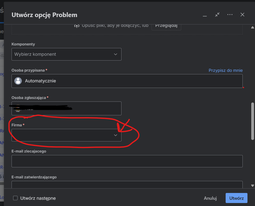

@Adam Tumidalski what do you mean by 'Company list'? I am having same issue, even outside of an agent, just providing a prompt with all required fields in the chat
Adam Tumidalski
November 12, 2025
@Marinela Boyadzhieva When you confingurated your agent and testing it last step before 400 is raw of issue and ABOVE it you can see a monit "there is one thing you should edit..."  click it and you will see with which one is problem. In my case agent had problem with companies list (we`ve got many of them) however same as CoPilot Studio on MCP or connectors.... ( after all our admins turn off obligatory picking name of company in creating issue )
