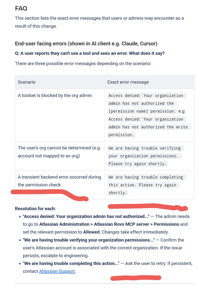

Also According to documentation this error message it's a transient backend error occured during permission check.
