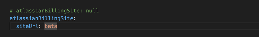

Can you run `acli rovodev config` and set the following value in the config file to see if this fixes the problem?
atlassianBillingSite:
siteUrl: beta

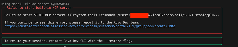

Config:
Error:
siteUrl: beta
It's work for me, thank a lot
@hwan19 your error seems related to the directory where you started rovodev. Did you happen to start it in a large directory such as your home directory, where some sub directory such as ~/Downloads, ~/Documents etc may have restricted access?
File access permission issues can cause the error you are seeing above - we're addressing this in an upcoming release as well!
Hi, yup right.
I started it in the terminal which is at the default user folder.
When in the certain, the issue gone.
Thanks for the help.
Add this section to the configuration file to take effect. Thanks.
siteUrl: beta
