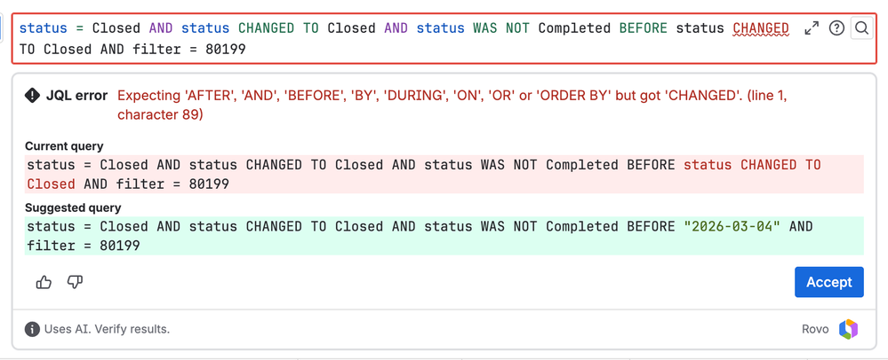

This one started with a very relatable moment from @Darryl Lee :
Rovo gave me invalid JQL… and the JQL Assistant said it was wrong too.
Oof. We’ve all been there.
What happened here?
Darryl asked Rovo to:
  • Analyze ticket history
  • Split results into “Done” vs “Rejected”
  • Generate JQL to support it
Rovo responded with… something that looked like JQL But:
  • It didn’t parse
  • It mixed incompatible operators
  • And even the JQL Assistant struggled to recover it cleanly
Why this happens
Let’s clear up the core issue: Rovo can generate JQL… but it cannot validate it. More specifically:
  • It does not run queries through Jira’s parser
  • It does not use the JQL Assistant validation layer
  • It does not fully understand your instance schema (fields, workflows, statuses)
So what does it do? It guesses based on patterns it has seen. That’s fine for simple queries… but breaks down quickly with:
  • Status history logic (CHANGED FROM, WAS, etc.)
  • Complex conditions
  • Filter chaining
  • Edge cases in workflows
