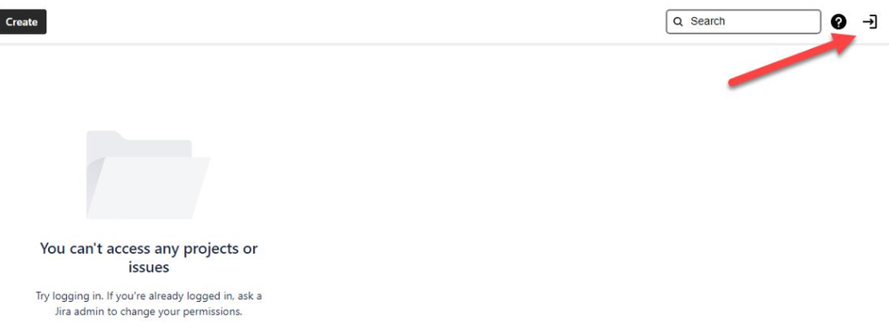

@Jimmy Seddon I think our configs might be different. When I opened my browser and hit my favorites button for Jira, I get this and then I have to click on the arrow in the upper right to login. If we leave Jira or the browser open we stay logged in.
@Bob Sochacki I think you may be correct that our configuration is different because you are correct that is not the same thing that I'm seeing.
