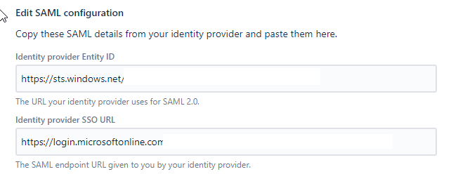

Hi Atlassian Support Team,
Unfortunately I can't login anymore. I've configured SSO with Azure Active Directory but now I can't login anymore to the Admin Portal.
I get the message:
This sts.windows.net page can’t be found
No webpage was found for the web address: https://sts.windows.net//?SAMLRequest=
HTTP ERROR 404
Can you please help me?

Check if the correct URL is set in the correct field, I mixed up Entity ID and SSO URL, picture shows the correct setup
Dani Perez
June 7, 2023
That's true. In my case, these values were mixed. Now I don't get the 404 error but the login does not work yet. I'm doing some tests and get back to you.

Dani Perez
May 31, 2023
Hi,
I'm having this same issue and everything looks ok. Actually it works without enabling "enforce SSO".
Any idea?

Alex Ray
January 4, 2024
Same issue here, it only breaks when I select the "force SSO" box on the authentication policy
Dani Perez
January 8, 2024
Hi. In my case, the issue was that the settings were reversed: There are two URL to setup on the SSO configuration on the Jira side. I set the wrong values. Once I put each of them in the correct field, this issue was fixed.
