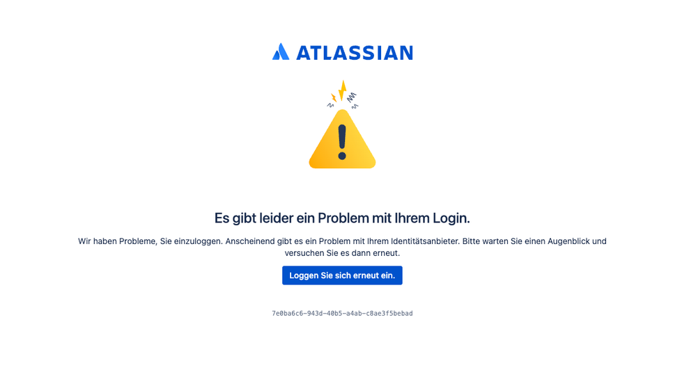

Then I am forwarded to Microsoft. I can log in there with my Azure AD access data (e-mail address or user principle name + password) and when I am redirected to Atlassian, I get an error.

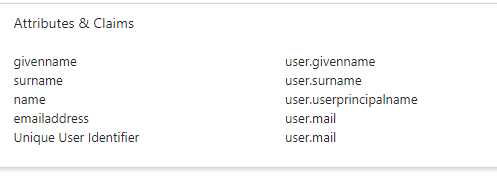

Mapping is as follows:
We have configured this according to the following instructions:
