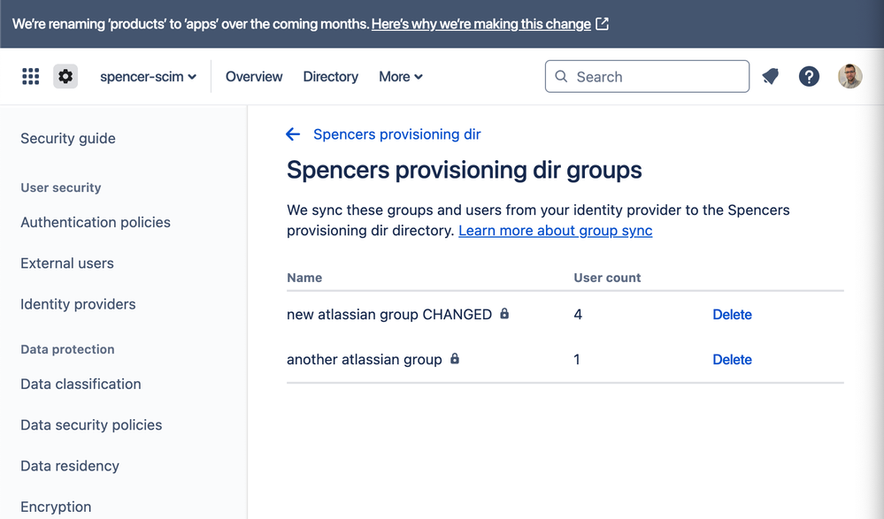

Navigating to Security -> Identity Providers -> <my_idp> -> View Groups, I can see the groups I synced over for testing, but see no way to assign app access to them. Delete is the only option.

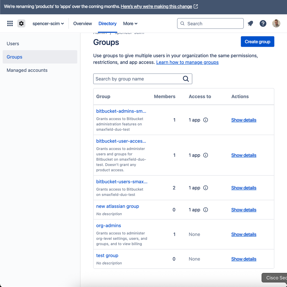

If I go to Directory -> Groups, the synced groups are not shown there, so from this view I'm only able to add app access to non-synced groups

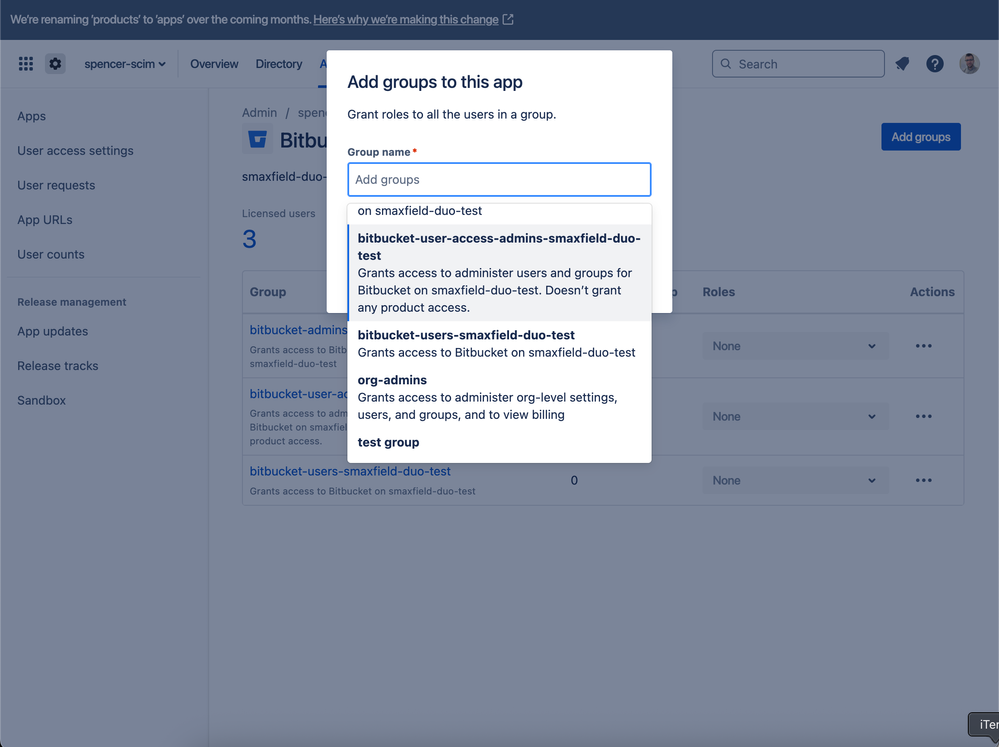

I also thought the Apps page might allow what I'm attempting, but that doesn't work either. Only non-synced groups show in the dropdown when adding a group to an app. Using my Bitbucket app as an example and clicking `Add Groups`:

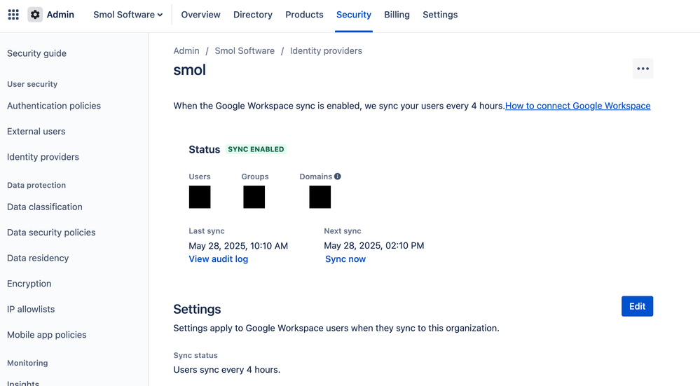

Can you look at the Identity Provider status page and tell us what you see? Here's an example of mine. Do the logs indicate that a successful sync has already occurred?

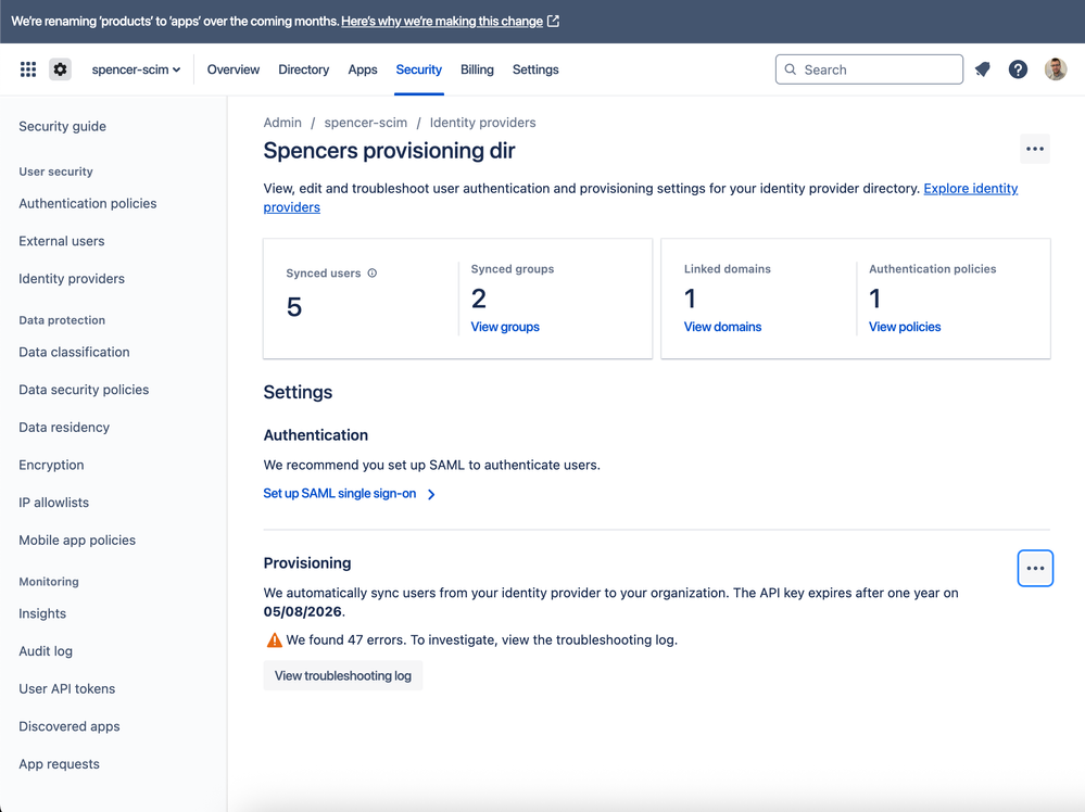

Thanks for the response! A screenshot of my identity provider page is below. A couple additional details I should have mentioned prior, just in case they're relevant:
More notably, it seems like provisioning works a bit different in my setup than what's in your screenshot. Yours has text stating "Users sync every 4 hours," which implies a "pull" from Google to Atlassian, initiated by Atlassian. In my case, there is no scheduled sync, but rather my app pushes updates to Atlassian on-demand, and there is no scheduled sync time. I'm not sure if any of that makes a difference to expected behavior in the UI.
Note: the error count shown for provisioning in the IdP screenshot page can be ignored. That's expected due to me testing various scenarios with my application's API calls.

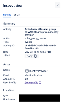

Do you have the logs from the APIs? I assume they were successful?

Correct, the group provisioning was successful. From the audit logs:
Screenshot 2025-06-02 at 3.36.32 PM 1.pngScreenshot 2025-06-02 at 3.37.07 PM.png
