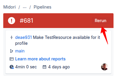

I looked up a failed build, and found this one (691) from 4 days ago, with the "Rerun" button available:
When I clicked "Rerun", it started a new build (693).

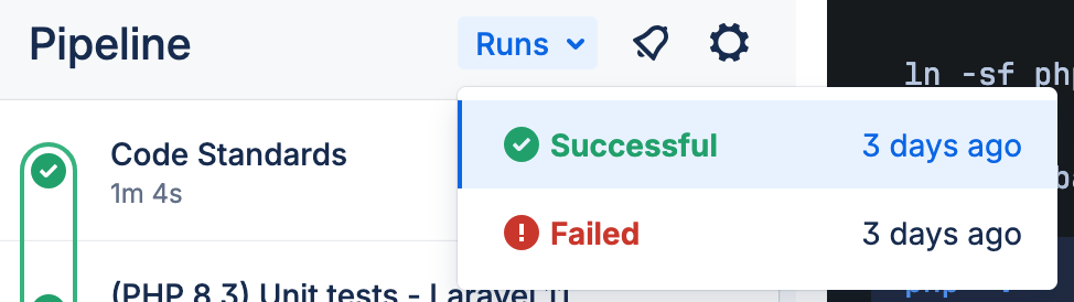

Radu Cristescu
September 29, 2025
When a failed setup is rerun on its own, this dropdown presents itself.

Ben
September 29, 2025
Hi @Radu Cristescu
The dropdown should show you the list of successful/failed runs for that particular build, and their associated logs when accessed.
As you're using the Premium plan - these logs are retained for 400 days as per our policy outlined here:
If you're encountering issues - please raise a formal support ticket using that Premium workspaceID as we'll need a support ticket for our system to allow us to grant the necessary access to your repository to check this on our end:
Cheers!
- Ben (Bitbucket Cloud Support)
