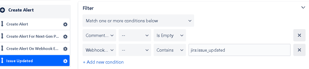

This is the filter I added:

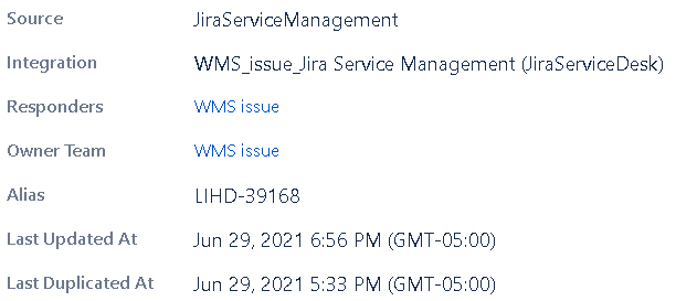

4. The alert was created in Opsgenie:
5. Since the on-call user was already working on it, the alert was NOT ACK'd

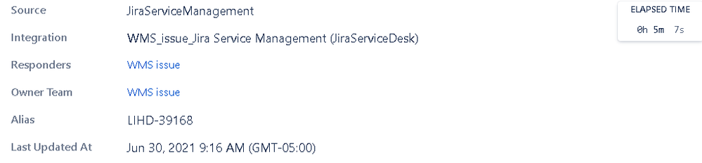

6. The ticket was closed this morning and a new alert was created:
7. Both alerts were ACK'd and closed

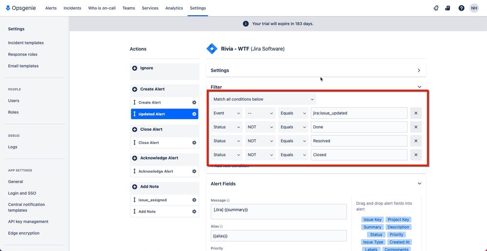

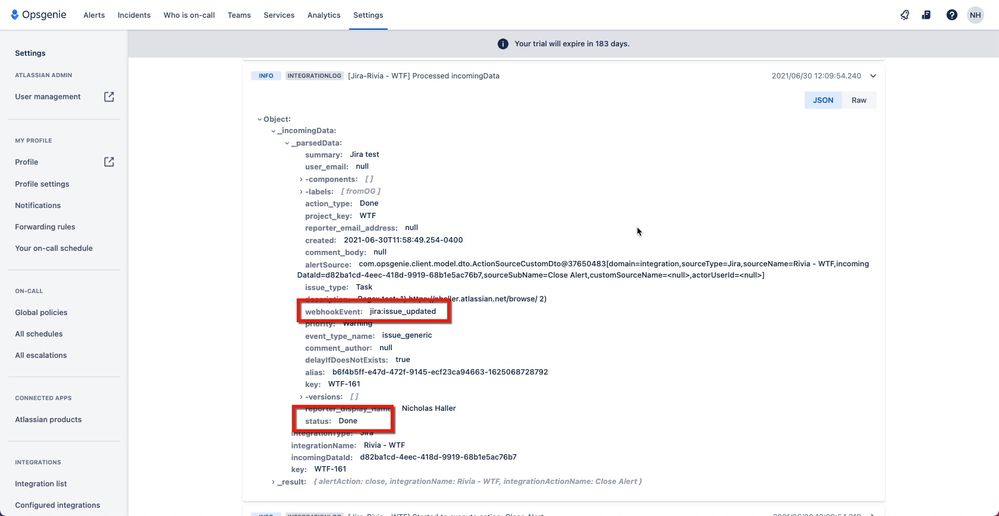

Closing the JSM issue would send something like you mentioned in the payload;
Event = jira:issue_updated
So your jira:issue_updated Create Alert action might also want to filter on statuses along with it:
