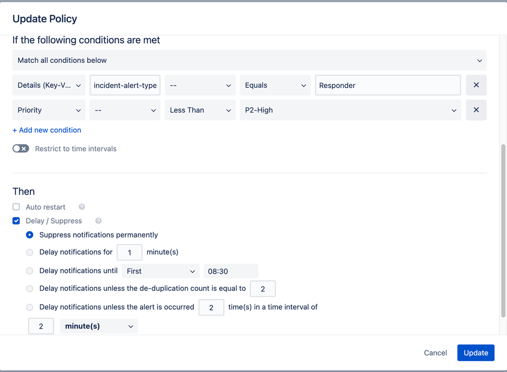

You're correct, there is no way to create an incident based on 'X' number of alerts. But, if you can figure out some way to have the alerts that are incoming increase in priority as the volume of alerts increases, then you could use a delay/suppress notification policy to block the responder alerts (the alerts that actually send out the notifications for the incidents) from sending out notifications to incident responders unless the priority is high enough.
This works because the incoming alert's priority will be reflected in the incident and aggregated alerts will continue to increase the priority of an open incident. I realize that you may not have an easy way to increase the priority of the incoming payloads based on the count/time, which is why you need Opsgenie to handle that.
