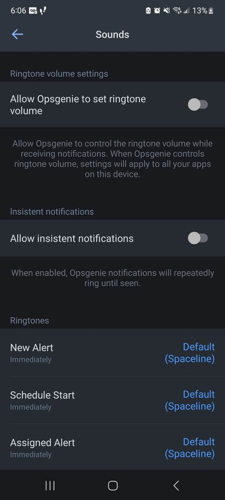

Hi Michael,
Happy to help! I checked on my own device (Galaxy 20 Android 13), and those other options are appearing normally:
This may have to do with your device, since OnePlus devices use OxygenOS rather than stock Android. I would recommend first reinstalling the app and then attempting to see if there are any app restrictions on the Opsgenie app that would prevent it from showing those other options. If that fails, you may want to reach out to OnePlus to see if they can point out anything that might be preventing those from appearing as a result of the OS. This article may also assist in troubleshooting that https://support.atlassian.com/opsgenie-android/docs/troubleshooting-for-android/.
Please let us know if you have any follow up questions

Shivam Naik
December 9, 2022
Hi @Michael Krug ,
It may be worth filing a ticket so we can examine this closer, but I would also recommend reaching out to OnePlus Support to see if they can identify anything specific to the OS that may have something to do with this.
