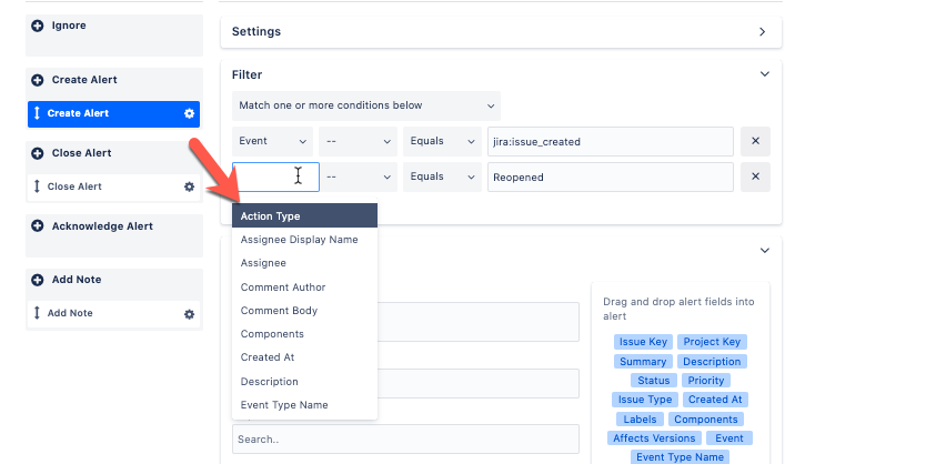

If you want to have an additional team added as a responder to the alert in Opsgenie based on the value of that specific field changing in Jira, we should be able to do this using multiple Create Alert actions in the Jira integration to set team(s) as responders based on the value of this field, assuming this field is one of the "default" fields that you can filter on in the Jira integration in Opsgenie?
However if this is a custom field which determines which teams(s) in Opsgenie should be responders, then this may not be possible as you can't filter on custom fields in the current Jira integration.

regarding the integration you’ve mentioned I assume the field I want is a custom one, but the entire screen you’ve showed is not a screen I’m working with, I wonder if I’m missing something here.
how do you get to this screen?

The Alert API just offers the "Add Responder" action, just like you can do in the Opsgenie Web App.

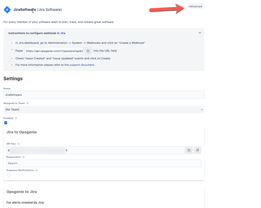

The screenshot I sent was from the "Advanced" View of the Jira integration...
e.g.
If you don't have that option, it's due to your plan not offering "advanced" integrations.

i'm not sure how to check what is my current plan.
while clicking on subscriptions on the opsgenie view i dont see anything related to opsgenie specifically (only jira service management - powered by opsgenie)
is this means i'm on the Free plan?
10x
Samir
September 13, 2021
Hi @chene ,
This means you are on one of the JSM subscriptions. JSM is a subscription that includes Opsgenie, so you are likely on the JSM Standard plan which doesn't have access to "Advanced" Integrations in Opsgenie. You would have to upgrade JSM to the Premium plan in order to leverage advanced integrations.
