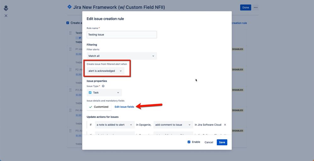

That should be possible with the newer cloud Jira integration. You'd want to create Jira issues when the alert is ack'd. That setup would look something like this:
You can customize which alert fields map to which Jira fields under the section above with the arrow:

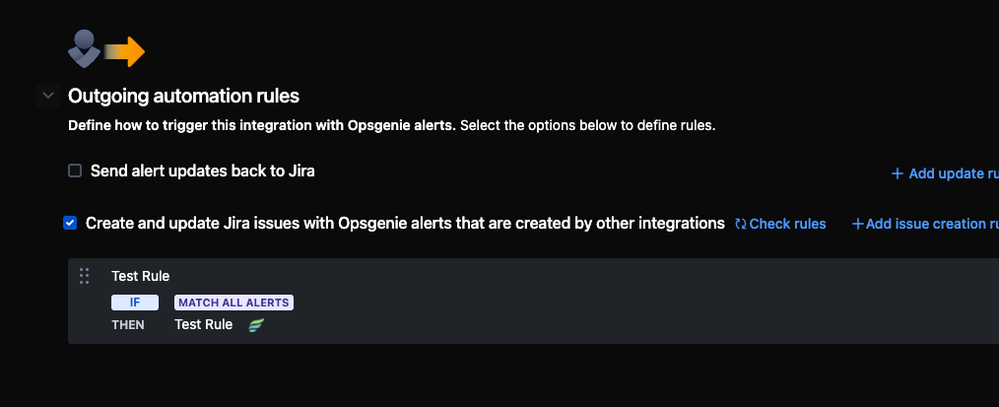

And here's a test in action:
Note that you probably only want one Create Alert outgoing action for this use case - otherwise others might match:

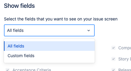

Interesting. So that for sure is the issue! When I go to view the fields I only see "Show fields" (I would assume that this is a permissions issue maybe?). I also don't get a search bar I only get "All Fields or Custom Fields" not a search bar like yours.
However, Once clicking on the "Show Fields" and sorting by "All Fields" I see that description isn't even in the list. Also this is all greyed out (assuming permissions issue again).
