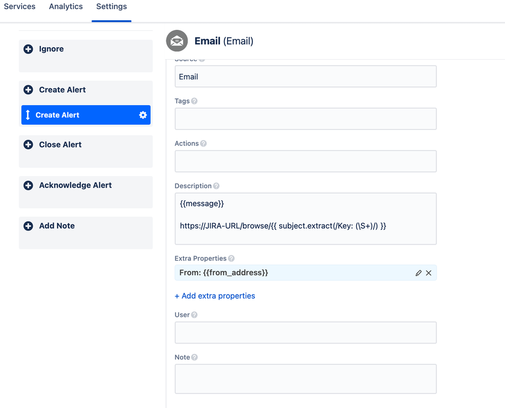

That is what the string processing and regex can help with. In the example below we are assuming that the issue key in the email subject comes after the string 'Key:' and that there is a space after it.
https://JIRA-URL/browse/{{ subject.extract(/Key: (\S+)/) }}

ok that works easy enough and there is a URL back to the issue in JSM.

One last thing, is the jira url something that can be extracted.
I know the value is intertwined into what is coming in but not sure where the best place to parse it and then add it to the //URL/browse... side of things.
It is there in the 'from_address, and I was trying to put that in here
https://from_address.extract(/@.........../browse/{{ subject.extract(/Key: (\S+)/) }}
the ......... represents where this just goes sideways :D
Ste404
August 28, 2023
Figured it out
https://{{from_address.extract(/@(\S+)/)[1]}}/browse/{{ subject.extract(/Key: (\S+)/) }}
