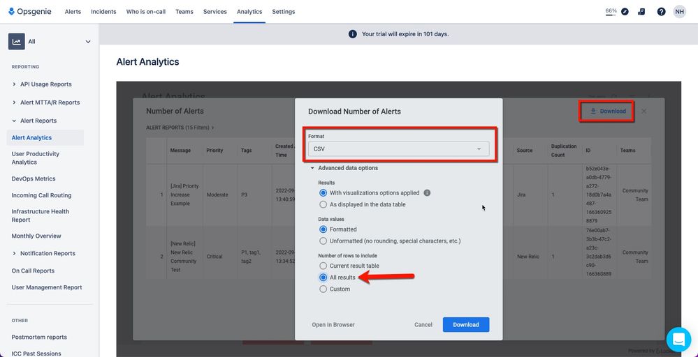

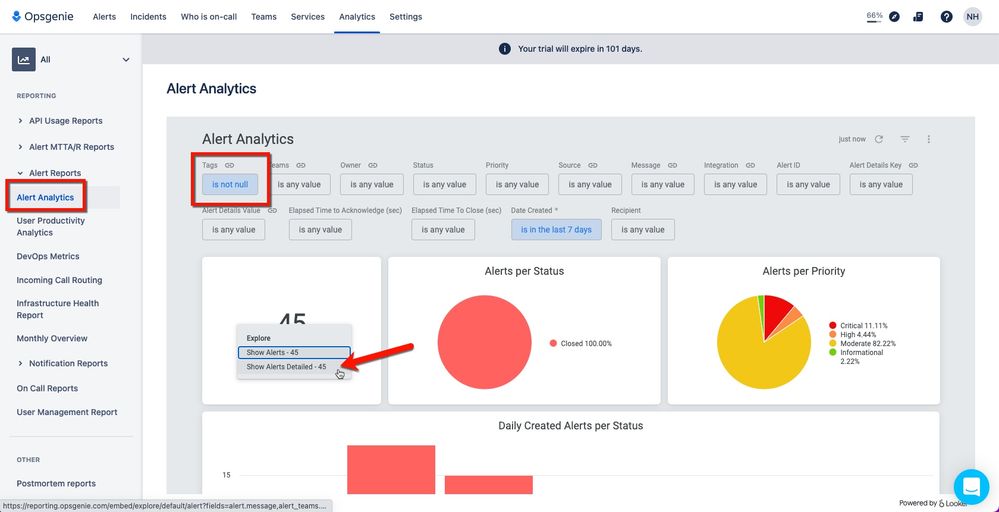

You could review the alerts in the Analytics tab >> Alert Analytics report. Add a filter that looks something like this, then export the list via CSV and manipulate the data there:

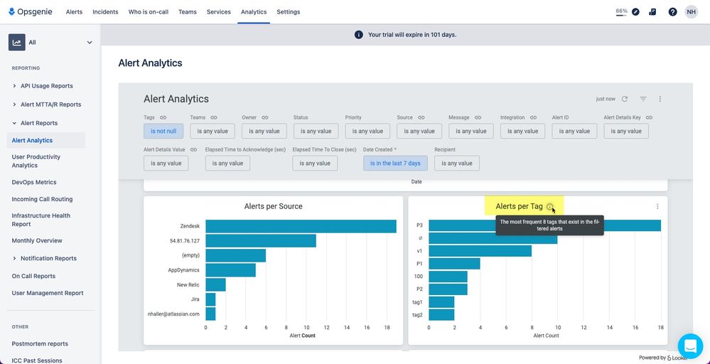

There's also this table in the Alert Analytics report that shows the most used tags based on the report's filter as well:

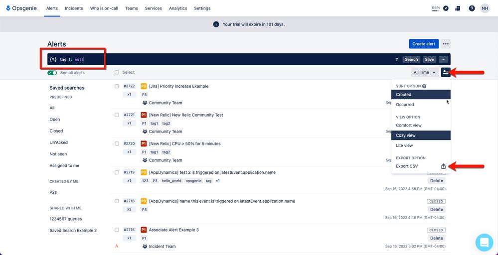

You could also run a query in the Alerts tab for something like:
tag !: null
and export these alerts via CSV as well:

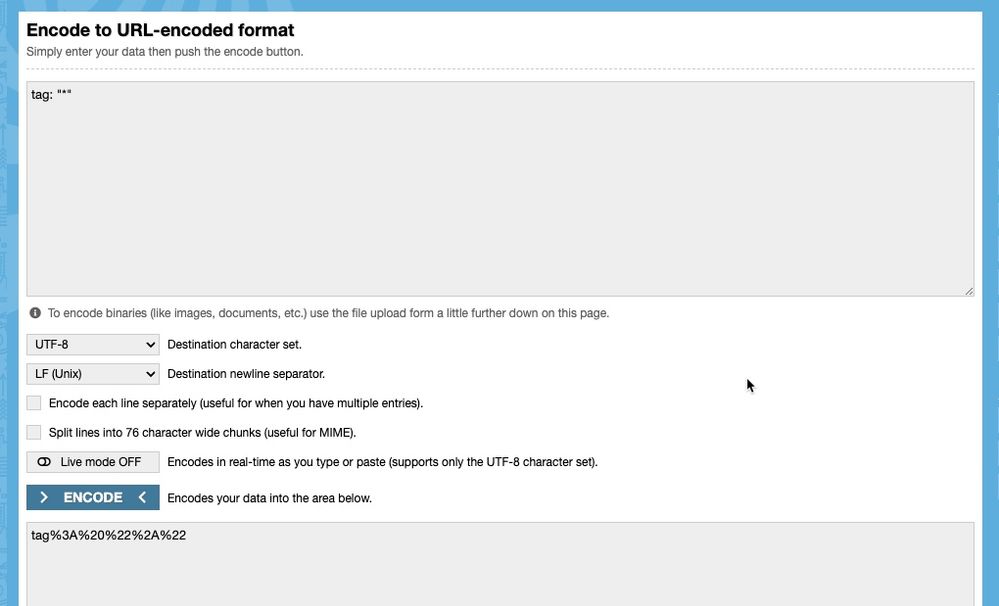

I typically use a URL encoder to help determine what the query should be:
