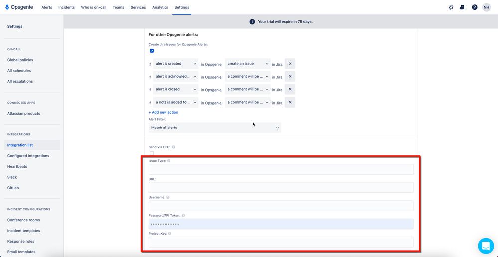

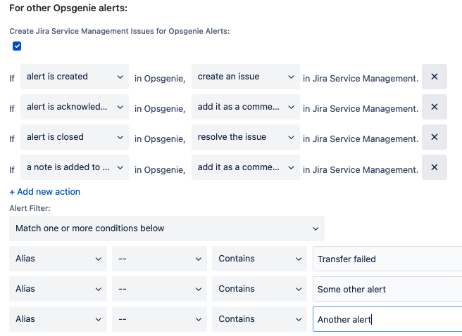

Illustrating an example (names changed for security): One of our OpsGenie alerts periodically comes in titled (Alias), "Transfer failed". We want OpsGenie/Jira Software to automatically create an Issue ticket in our "Tech Support" (TS) Project, when this alert is created in OpsGenie.
As far as I can tell, you can only configure this from OpsGenie > Settings > INTEGRATIONS > Configured integrations > Jira Service Management > Settings > For other Opsgenie alerts:
Is there no other way to automatically create issues from an OpsGenie Alert?

Hi @Elisa Escapa ,
That is correct - the only way to create Jira issues from Opsgenie alerts is through the For other Opsgenie alerts: section within the integration.

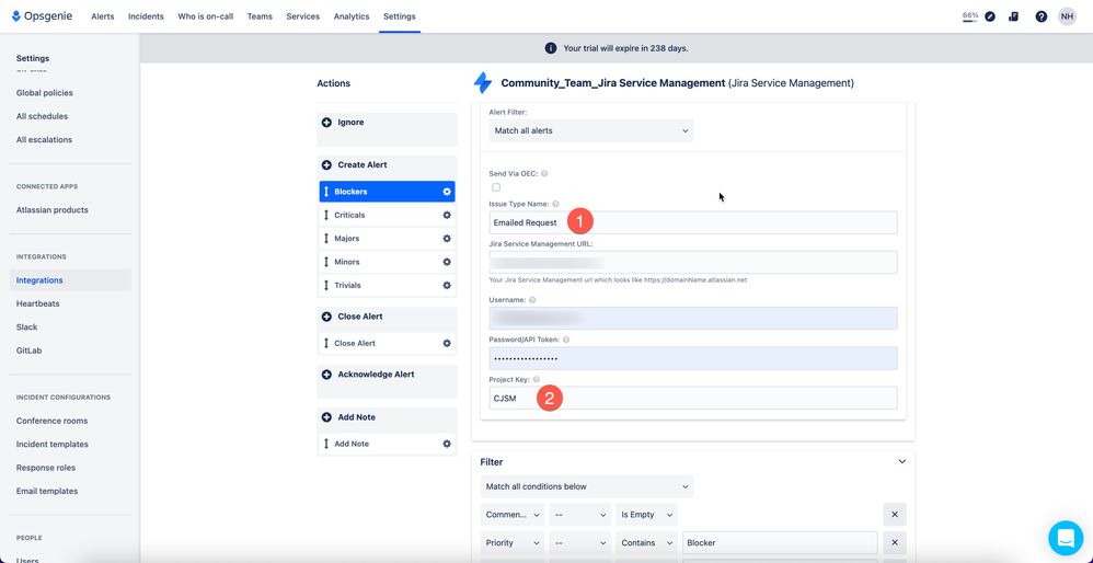

Based on the screenshot you shared above, any alert that contained one of those conditions in the alias field of an alert would trigger the integration, and create in issue in the configured Jira project under these settings:
^ That's where you'd configure Issue Type; Ticket, and  Project Key; TS.

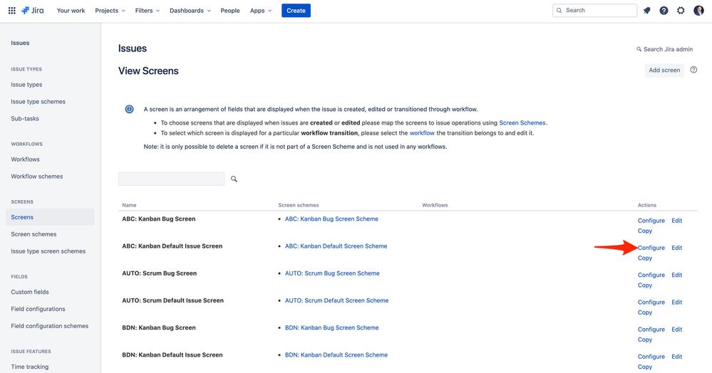

Like that error indicates, the labels field is probably not on the correct screen of the project / issue you are trying to create.
In Jira/JSM navigate to the Settings menu → Issues tab → Screens tab → Configure the same project’s screen that is configured in the integration’s action mapping section:

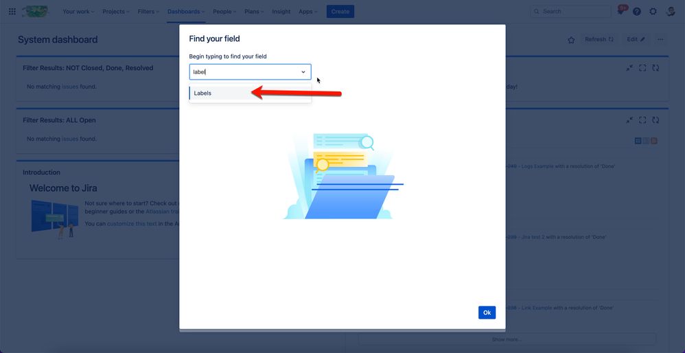

Another way to check whether or not this field is available is by trying to create an issue in Jira/JSM with the same project + issue type configured in the integration:
^ This should tell you whether or not the field is available. Then you can follow the steps outlined in the first part of this comment to add it.

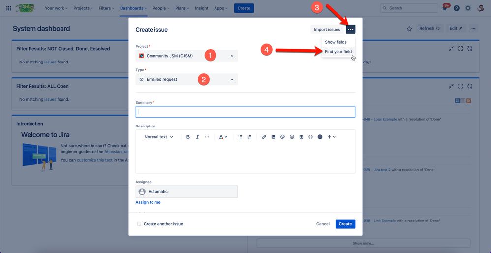

As well where to check through a test issue. Before creating the issue under the same project / issue type configured in Opsgenie integration, select the Find your field option.

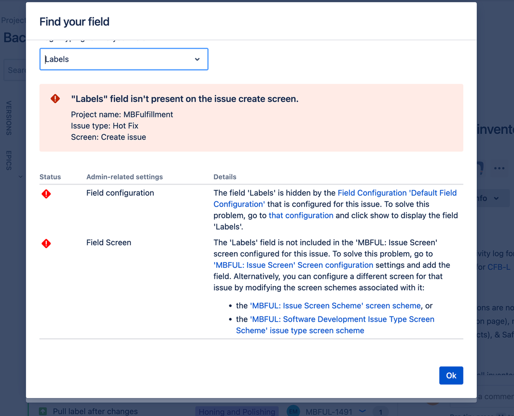

Edon Freiner
May 6, 2022
Seems like this is what I get, but we dont use this field, why is opsgeni requiring us to use it?

Nick Haller
May 6, 2022
Opsgenie sends a label (fromOG) to Jira / JSM when an Opsgenie alert creates a Jira / JSM issue. Which is why it's required.
