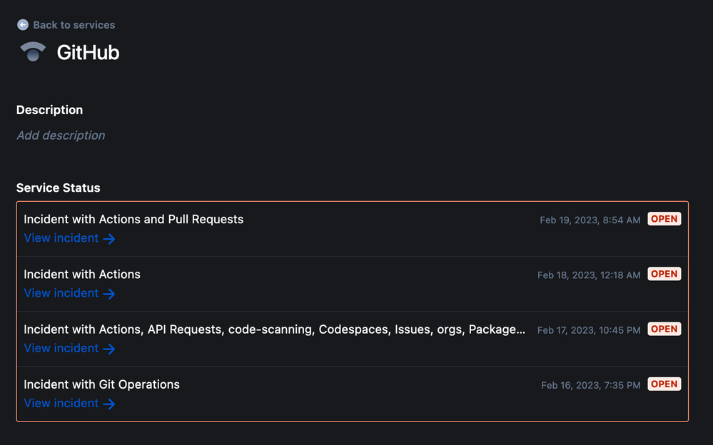

In OpsGenie, we have added GitHub's StatusPage as an external service:Screen Shot 2023-02-22 at 12.01.35 PM.png

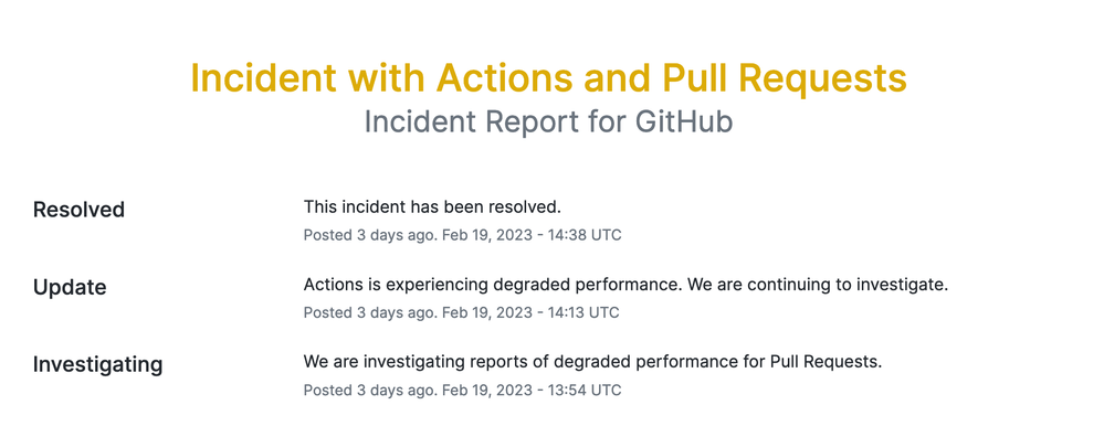

You'll see in the screenshot above that there appear to be 4 open incidents with the service. However, each of these incidents are closed on GitHub's end. For example, here is a link to the first incident in the list above ("Incident with Actions and Pull Requests - Feb 19, 2023, 8:54 AM") https://www.githubstatus.com/incidents/pd991fsqrw9s.

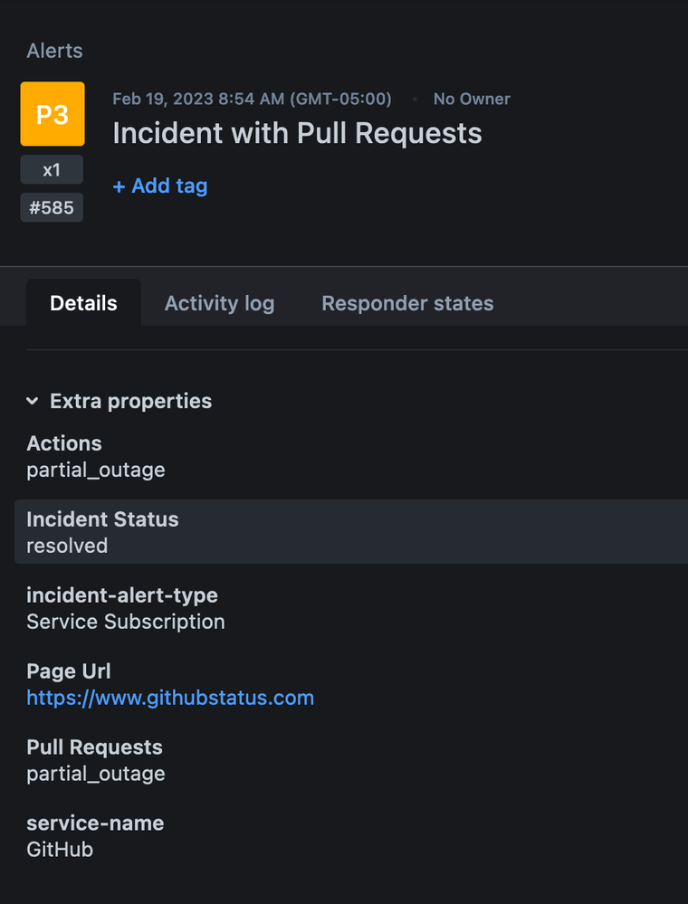

Additionally, the incident creates an alert that does not close upon resolution of the incident, even though the Statuspage integration has updated the alert with `Incident Status=resolved`:
