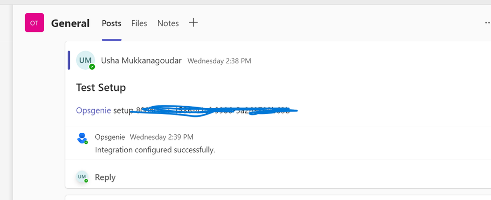

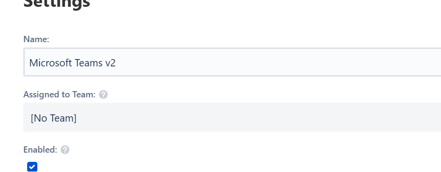

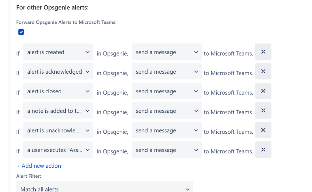

I am facing issue getting alerts in Teams.
I have completed the integration (says successful as in image) but still unable to see alert posts from Opsgenie.

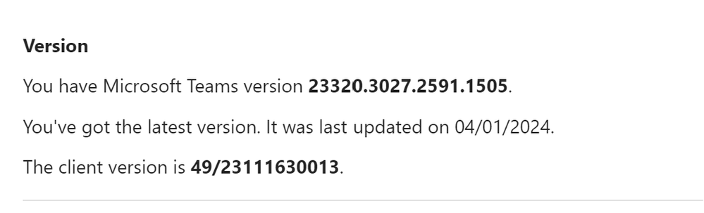

Attached pics above - Integration , Alert config for teams & MS Teams version
Please let me know if I am missing something & any further information required.

One common reason for alerts not being sent to MS teams is that the integration is assigned to a team but the alert is not. If the integration is a team-based integration (assigned to a team) it will only send alerts where the owner team matches.

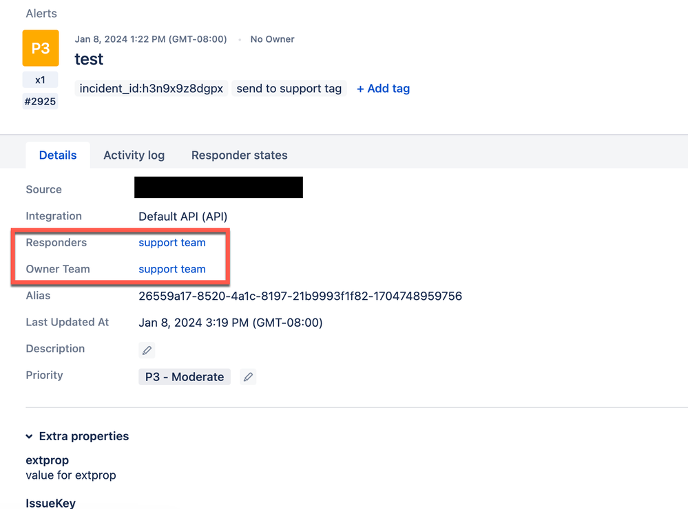

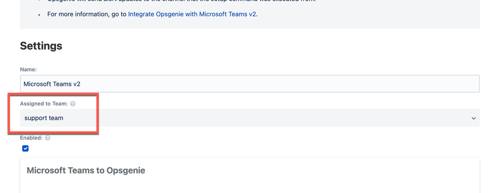

Hi @Usha - The team members can be different, but the alerts need to be assigned to the same team as the integration.
Here the alert's team:
Must match the integration's assigned team:
