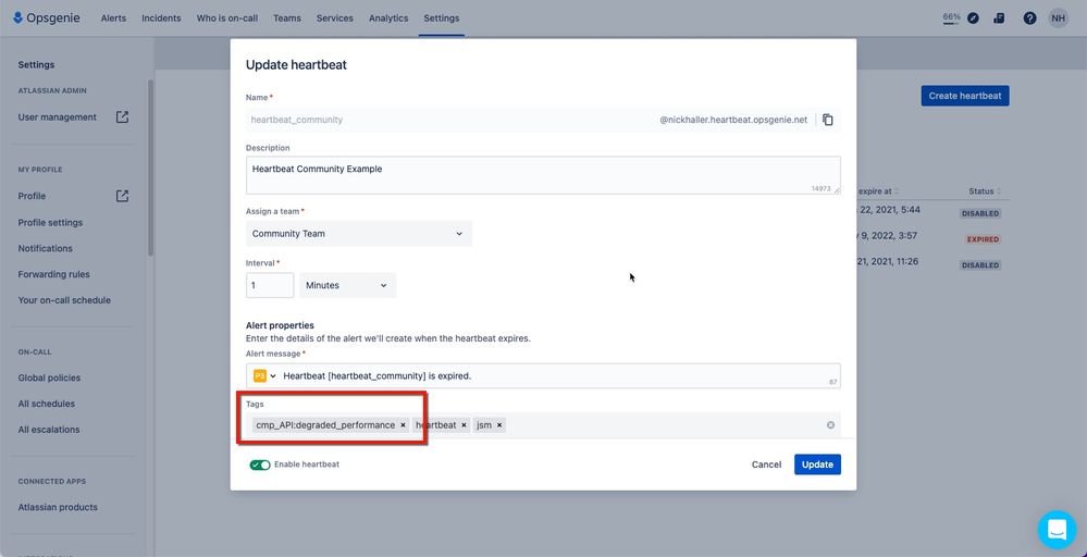

The heartbeat would need to add the affected component tag when the heartbeat-alert is created:

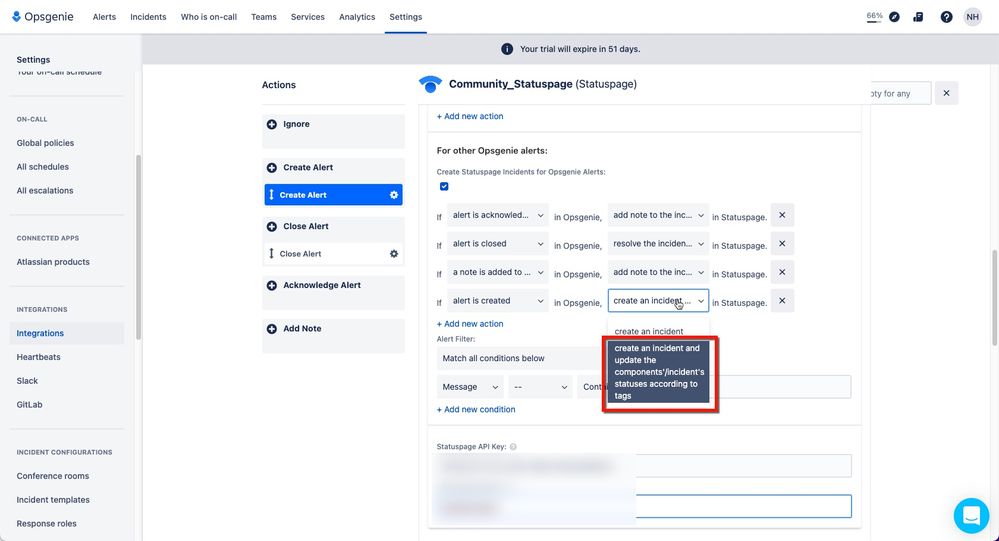

And the Statuspage integration would need to create an incident AND update the components'/incidents' statuses according to tags when an alert is created:

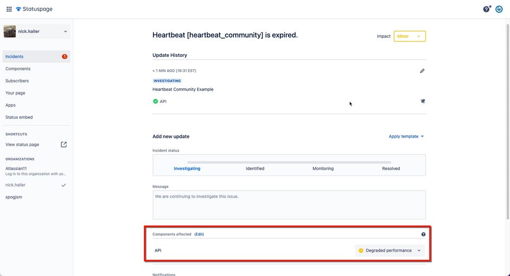

Our Statuspage document should help determine the format of the tag under the Changing Component/Incident Statuses via Alert Tags section. Here's a few examples shown in there as well:
  • cmp_API:degraded_performance
  • cmp_Database Server:partial_outage
  • cmp_Management Portal:operational

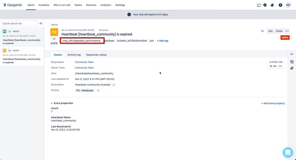

And a test to prove this use case is possible through an expired heartbeat:
