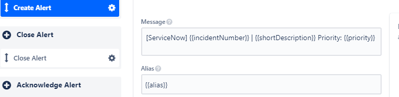

This is what we have, I have tried replacing alias with the incident number as well but no luck.

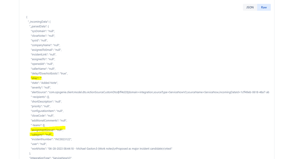

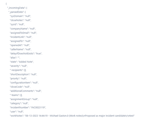

Pretty much everything is coming through as null even though those fields are also mapped, specifically category and priority, but incident number does come through. Alias is blank. I tried to put the incident number for alias on the OpsGenie side and the log still shows it coming through blank.

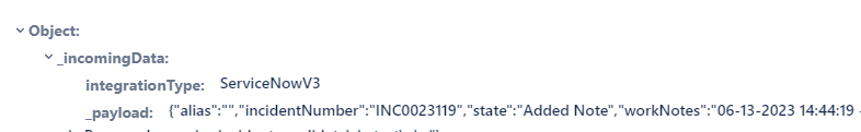

It could be that the filters on the 'create' action aren't matching the payload. I would suggest searching "INC0023119" (with quotes) in the debug logs to see if the 'create alert' payload was discarded.
I'm not sure how to tell if its been discarded, but here is also shows the alias as not having a value.
@Michael Gaston That is the raw payload before it is processed by Opsgenie. When the alias is blank Opsgenie will assign a default alias. But if that is happening, none of your other actions after the initial 'create alert' will work since the alias is being assigned by Opsgenie and not by Service Now. If the payload is being discarded there will be a separate warning log that states the reason.

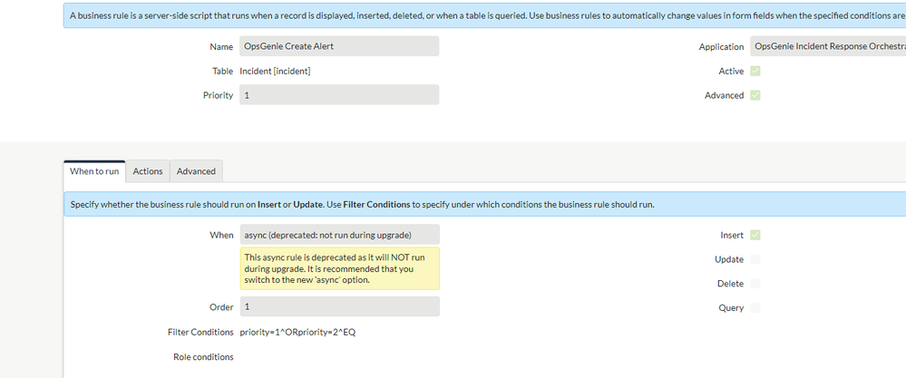

I went ahead and updated the api key to be set in our test environment to see if it was an issue caused in our dev environment, and i'm no longer having an issue with the alias coming over. After running more tests it looks like the issue is caused by the "when to run" setting on the create alert business rule. By default this was not set to anything in test so the alerts were coming through correctly. However, when I try to adjust this to only create when an alert is P1 or 2, or if I say only run when a major incident is proposed, it no longer flows through correctly. It does create the alert but sets most of the values to null including the alias like before.

With no filter set on the when to run tab, in the opsgenie create alert tab, the alert comes through with all the information that's listed to be mapped.

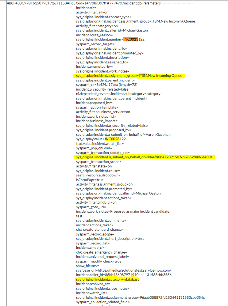

When I specify when to run, that's when data is showing in the opsgenie alert as null. In the Snow logs I can see that some of the fields do have the data needed, but others do not. I've highlighted these fields in the screenshots provided.

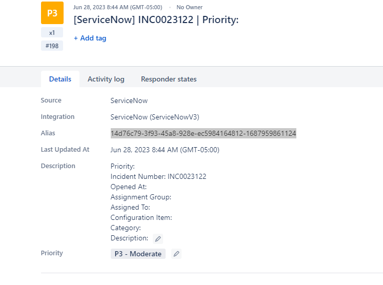

The first image shows the alert in opsgenie with the business rule filter applied, its applying a value i cannot find in the ServiceNow for the alias. I can also see that the category is blank when it does show a value for this field in the log.
The SNOW log shows that there's a value for the category field, but this does not come over to the opsgenie alert. The value for the alias in the opsgenie alert is no where to be found in the log, so i'm not sure where that is coming from.
