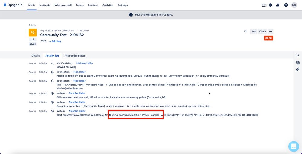

If possible, check some of these recent alerts and the activity logs. If any policies are being applied, they'd appear like so:
If that's the case, review the alert policies because one (or more) could be adding these additional teams to the alert at creation.
If that's not the case, the alert's activity logs might still provide some insight into why these additional teams are being added.
