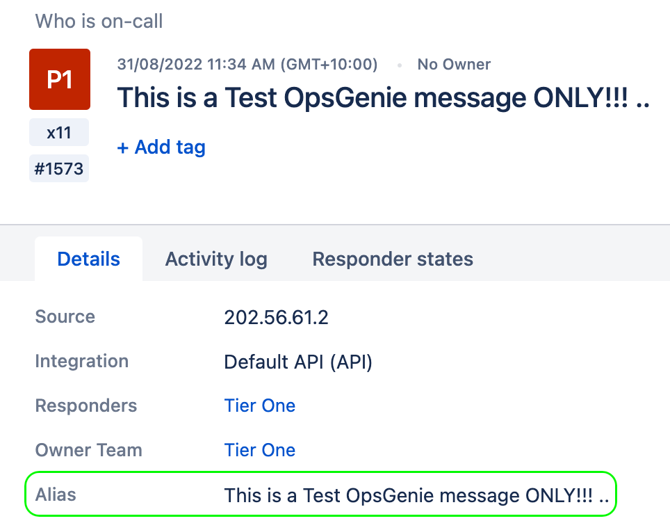

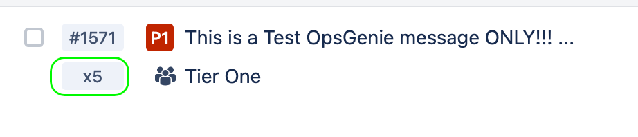

As a follow-up, this did exactly what I needed -- thank you very much for the advice!

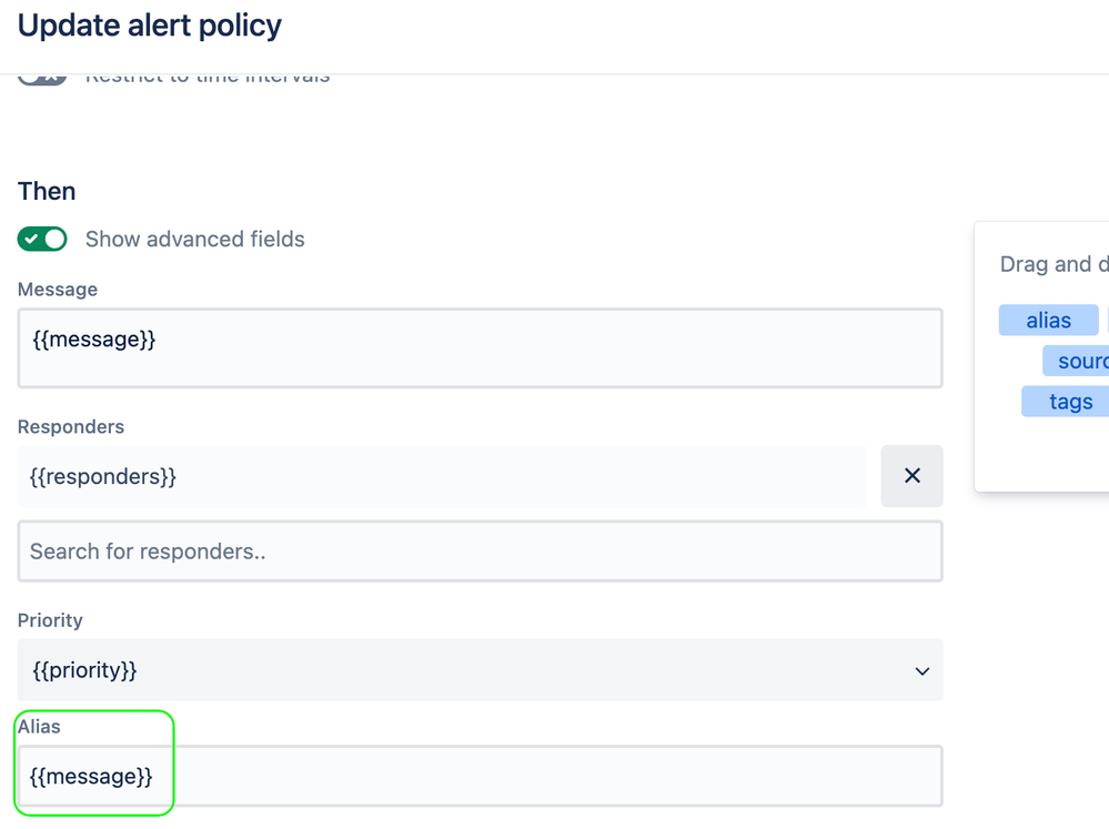

I found that the Alias was coming in as a UID which was always different, so what I did was I created  a settings->Global Policies that set the Alias to equal the message..
It works now 👍
Here are a few images that others may find useful.
