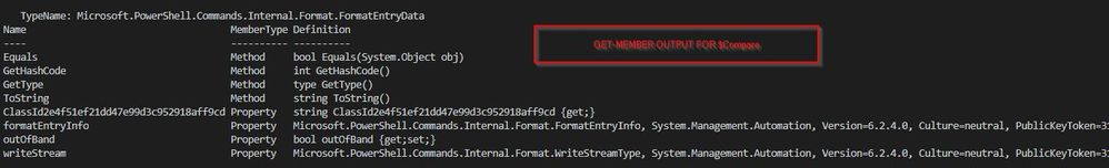

Previously, I used this format which worked except when I attempted to use the responders and tag fields. I was able to send my variable (list of servers) using this format before and it displayed correctly by displaying the servers in the $myvariable powershell object.
Microsoft.PowerShell.Commands.Internal.Format.FormatStartData Microsoft.PowerShell.Commands.Internal.Format.GroupStartData Microsoft.PowerShell.Commands.Internal.Format.FormatEntryData Microsoft.PowerShell.Commands.Internal.Format.FormatEntryData Microsoft.PowerShell.Commands.Internal.Format.FormatEntryData Microsoft.PowerShell.Commands.Internal.Format.FormatEntryData
Using the literal JSON format method as you showed up there, it does try to send an object this time instead of just the variable name, but it's more like the object typename and not the object itself. The above is what's shown in the opsgenie notes section using your formatting above.

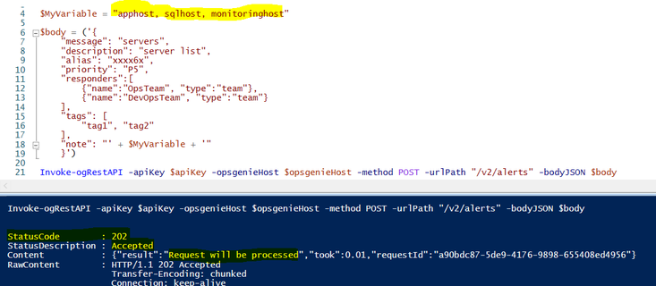

Can you please provide an example of the $body PsObject with Responders and tags included in the object.  Can you also provide an output of that $body after it has been piped to ConvertTo-Json that way you can view the converted JSON in your shell.  I would like to see the how ConvertTo-Json is constructing the JSON so I can run a validation check to make sure it compliant with RFC 8259 JSON standard.
Please note we only support JSON paylaods that compliant with RFC xxxx JSON standards, please further note that we only support JSON formats we do not support the conversion of JSON from other objects such as PsObject.
Please see the screenshot of a working example of the syntax that I provided my previous message, as you can see the API accepts the request with a HTTP status of 202 and returns a JSON which confirms the request will be processed.

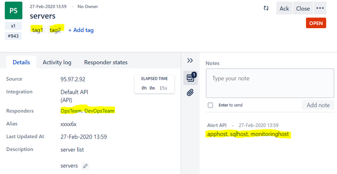

And here is the resulting Alert in OpsGenie, with responders assigned and the $MyVariable value string correctly displayed in the notes.
