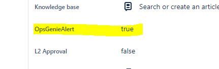

If I have a field on a JSM issue called "OpsgenieAlert" with a value of true or false, is it possible in Opsgenie to only create alerts from issues if that value is true?

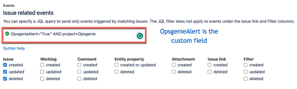

Unfortunately, from Opsgenie side we don't have the option to filter alerts directly from the payload. However, if you are sending alerts to Opsgenie via Webhooks you should be able to filter the action to send alerts if the field has the value you are looking for.
Here is an example JQL for your reference, here OpsgenieAlert is a custom field in JSM.

I set up the JQL that reads OpsGenieAlert = "true" which matches the custom field on the issue when it is created, but it doesn't fire.
Is the webhook triggering before the custom field update automation is run?

Yes, it could be possible that Webook is triggering before the automation rule is completed.
You might want to check if it is possible to invoke Webhook via Automation rules in Jira to see if that works for your use case.
